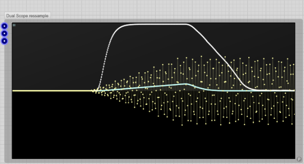

Hi,
What do you think of this peak detector ??
I wanted one that could flash fastly, detect the transient, then stop fastly too.
Was struggling a lot to make it works like i want.
This is for overdrive/distortion that would affect more the transient.
Wanted also that one note or multiple notes does approximately the same think.
(one note would normally do less envelope)
I'd like the result for now but not sure if in some way it could be too much sensible, or do some bad think...
I already seen a little problem but with not so much disagreement : Sometime it would make a peak after some note, when there is no more signal; but that's not so much a problem to distort an inexistent signal.
Any advice to make it better or problem spotting ?
- Peakdd.png (61.11 KiB) Viewed 29312 times
- Peak detector.fsm
- (43.12 KiB) Downloaded 1027 times

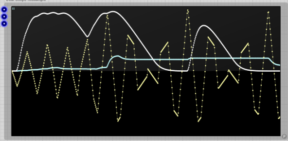

Re: Peak detector (is it good ??)
I spot a little problem with bass..
When multiple bass notes are played the detector could continue to be up and down when we are no more on transient..
(Should have name this a transient detector more than a peak.)
I could make the release longer but not sure it's really what i want..
Separating bass and treble and treat them separately ? But this give more latency (even if it's a very little.)
I think about a cross detector that will adapt the release according to the frequency...
- TransientBass.png (64.46 KiB) Viewed 29256 times
