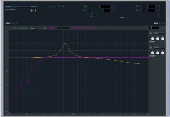

Hi all
For purposes related to R&D of high-end audio systems, I am currently developing an equalizer tool with both FIR and IIR integrated. It is largely based on contributions from others in this forum, like Martin Vicaneks FIR algorithms. I have taken the liberty to adjust the GUI and gear it towards the typical stereo-audio developer, with a "proper" BODE graph etc.
The non-surprising mandatory and general requirements I have defined for this work:
1. No audio quality corruption. (For example, artifacts close to the Nyquist, proper IIR modules, etc)
2. Scrupulously, no modules that triggers the CPU usage problem of Flowstone. The current version is not CPU intensive. It is a 0.0% here
Would anyone be interested in taking a look at it?
For example, I just made my first ever Ruby code and it could need a ruby expert to review it.
And, are there other things I have done that is less than optimal, generally "Flowstone" speaking?
Are there any modules available in this community that you would suggest to be integrated?
In particular, has anyone made a systematic multi IIR module of proven audio quality?
Regarding FIR: I do not comment now, but there are several very interesting features that could be included, some of which have already been presented in this forum. One thing is the number of Taps, which needs to be generalized. A slider is included to indicate that.
This version: Contains 2 IIR modules just to show features. One can imagine e.g. 8 instances. Number of IIR instances can be adjusted with sliders. There is this and that clickable button (toggles). Try! Only PEQ and 1pole shelf is included, so the IIR module has some TODOs.
There are more TODOs inside. Would anyone be interested in partaking in finishing up this Equalizer as a general purpose tool? If so, we could create a "token" so that one participator at the time made his/her adjustments, then the next, etc. But some modules, like FFT dynamic graph, could be developed in autonomic mode, then inserted back.
For me, this would be 1+ week of work. For more competent personel, much less. So it is not a large project.
The first milestone is to complete this module with e.g. all iir types, one graph (two now, overlayed), proper preset mng, etc. Then some added features, like a smoothed curve dynamic FFT display (rocko's version is inside but not connected). It is not really that much work, but I will strive with Ruby and hope someone more competent could take a look at some of the TODOs indicated, like integrating the curve graphs into one module.
AFTER THAT, I will develop this further into a live loudspeaker prototyping tool. To my knowledge, a "live" tool with which one can develop e.g. a 3 way system, is not in existence. It would attract attention among speaker builders because it would be a huge timesaver to be able to do all development in this tool, then export results to either a passive or a active crossover. Such a tool would also need import and export features, e.g. speaker driver measurement, a house curve, and more.
But first I hereby investigate if anyone would be interested in collaboration.
Thanks!

Hej chjan,
I can help with the DSP side of the project. Some immediate comments on your schematic:
1. You make frequent use of selectors (and multiplexers). Bear in mind that upon switching, these interrupt the audio and recompile the schematic. As an alternative, consider multiplying by 1 or 0 (or even a ramp for soft switching).
2. Inside the schematic you mention Linkwitz Riley crossover. IIRC I posted a schem some time ago, it might even be linear phase.
3. Today I would not use direct form biquads for high quality audio, not even in static filters. I can offer better implementations.
4. I also have better matched magnitude responses for peaking EQ, shelving filters etc. today than I had back then.
5. Today I would definitely use a longer FFT than 1024, preferrably make it user selectable as you suggest.
6. One could use partitioned convolution to reduce latency in FIR filtering.
7. This project is >> 1 week.
8. Please advise if you post schematics made with FS alpha.

BACK FROM ACCOUNTING. I RESPOND; THUS:
Would it be possible for your to show an example schematic (module) that could be used to replace selector and multiplexer? Is the recompile affecting the schematic ONLY when the switch is done, or could there be audible consequences when the switchs have been set?
LR crossover is one thing. For a speaker prototyping tool, all the major filter types should be selectable, like LR, Cheby., Butterworth, etc. There are even special filters like Duelund variants and others.
Phaselinear vs Minimum phase: Per definition LR and others are minimum phase, but it would be VERY interesting to present a linear phase variant of e.g. 1st, 2nd, 3rd etc order filters, as well as a brick wall variant.
What I meant here, not precisely descriped, is the LinkwitzR bass compensation circuit that is VERY common for active subwoofers and speakers. Because the speaker itself is normally minimum phase, the LR circuit will flatten the response (in principle) and therefore also the phase response, thus creating a linear phase end results. It is this LR EQ circuit that needs to be available as a feature. It has 2 poles and is not unlike shelf filters.
As time allows, please present them! I have read your White paper on some of this, but it would be very good if you have reasons (mathematical or otherwise) to illustrate the weakness in direct form bquads, vs strength in your own implementation.
Same response, please present.
That's why I made the tap-slider and ms delay indicator. Brick walling at lower frequencies requires larger nof taps. I have java code for producing FIR filters in whatever tap dimension, but nothing for Flowstone. There are a few other things you have that is also very interesting. One is the ability to automatically reproduce/mimic an arbitrary SPL response, only, it could be used the other way around; to create the reciprocal (inverse curve) of such a response. That would be a great tool to check how your speakers are sounding when flattened in its response. One could then add a simple "house curve" as it is called, e.g. the Harman Kardon "default", and incorporate that response to the SPL response and therefore create a "flat" and(or hourse curve response for a speaker system.
Another interesting feature would be to use the same principle to rectify a systems measured phase response. The reading in of SPL and Phase response should be easy peasy, for example as produced as results from the use of REW, a free tool used by the whole world. REW can export as txt, convolution or other formats. Same with impulse response, it can also easily be retrieved from REW.
Please explain in more detail.
Yes, but the basic equlizer tool should be first milestone, and when that is available it is available for this and that new project. That should not be more than a week, with the exception for replacing Flowstone Biquad with enhanced versions etc.
I use 3.09 B2. Unaware of alpha versions. Should I swap to a newer version (or older)? Please advice
Re: Invitation: FIR + IIR equalizer in the need of collabora
Here is a set of matched (static, i.e. not modulateable) standard filter types.
I'll also respond to the other points, bear with me.
- Matched Filters IVc.fsm
- Fixed zero gain bug an another minor issue
- (50.52 KiB) Downloaded 848 times
