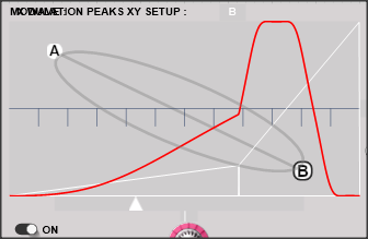

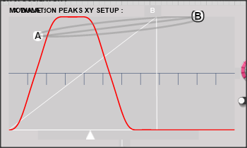

As I see it, on the picture is tri. osc multplied by 3 and streamed only in -1 to 1 range, min/max. If sub. or add value 1, it will act as phase shifting. I dindt take in depth look but I was working on something similar so its my association... The MIX controler between this X3 wave and before state should do the dashed lines on the picture.
family jewels :D : (cant post it all, only parts) x64 alpha

Not sure what you mean - the graphic I posted is not of an oscillator waveform. It shows output levels of two operators at increasing settings of the Level control. I described the resulting output levels in the text.

The level increase from 0 to max is one phase of osc. finished - same as level control . The wave design is here described as output levels of two operators at increasing settings of the Level control
Simply: plug the level into phase and you need the wave - and thats the whole of what i wrote about.
You see on my picture the pretty close match.
The misunderstand was in modulation between the the two in whitch I am interested. If its not there in the real synth, than for emeulation its useless.
