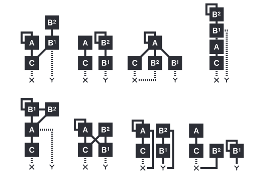

The basics of it's FM voice:
Just stumbled on an article about this FM synth and it looks to have a fascinatingly fresh take on 4-OP FM, that combines some simplification with added flexibility (including filters).
Has anyone done or started a project that implements some of it's interesting ideas? If not, I may take a stab at it in my tinker-toy non-coding way. Love the sound of FM, and always keen to look at ways to make it friendlier to pgm. The Digitone appears to make smart and musical choices in it's simplifications - i.e.: OPs B1 and B2 share the same EG, etc.
If I do tear into this, I may come begging fer help with the EGs - they're a bit unusual (though FAR simpler than DX7).
https://www.soundonsound.com/reviews/elektron-digitone
https://www.elektron.se/wp-content/uplo ... 210602.pdf
- Algos.png (30.37 KiB) Viewed 24481 times
- Screen Shot 2021-11-27 at 2.46.47 PM.png (84.85 KiB) Viewed 24481 times

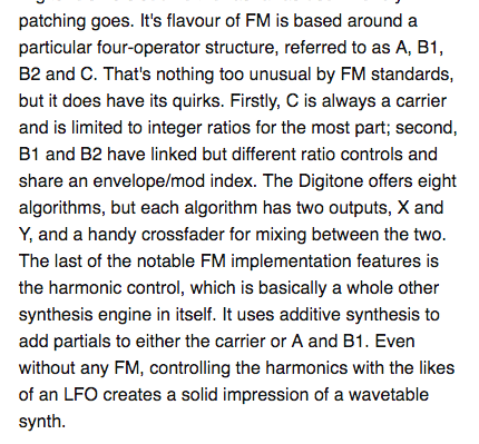

When they say that Op C (which is always a Carrier) Ratios are limited to 'integers', I assume that means whole numbers only? (Page 91 of the manual).

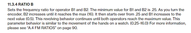

I understand what's described about Ops B1 and B2 Ratios control (a great concept), but nothing's coming to mind about how to implement it - anyone have any ideas? See below. (Near top of Page 91).

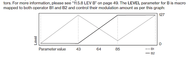

Also drawing a blank on how a knob might simultaneously control Ops B1 and B2 levels as shown on Page 92. A damned clever concept for FM Ops' level control - a unique triple-action crossfader. One output that goes 0-1 for the first third of it's range, then 1 to a bit above 0 for the second third, then back up to 1 for the last third (!). Second output that's stays at 0 for the first third, then up to 1 for the second third, then stays at 1 for the last third. Sure- no problem! This would probably need Ruby?

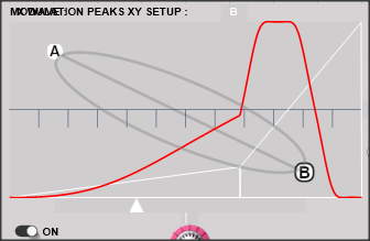

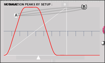

The unusual Operator envelopes are described on Pages 49/50 and 91; I may have something in the toolbox that I can adapt, but I'm not terribly confident ; - (

k brown wrote:When they say that Op C (which is always a Carrier) Ratios are limited to 'integers', I assume that means whole numbers only? (Page 91 of the manual).
Yes.
k brown wrote:I understand what's described about Ops B1 and B2 Ratios control (a great concept), but nothing's coming to mind about how to implement it - anyone have any ideas? See below. (Near top of Page 91).
That clock-like bit? Just make it like a clock. Endless encoder, one 360° turn updates the second value to its next turn, while the encoder value is reset to 0.25.
k brown wrote:Also drawing a blank on how a knob might simultaneously control Ops B1 and B2 levels as shown on Page 92. A damned clever concept for FM Ops' level control - a unique triple-action crossfader. One output that goes 0-1 for the first third of it's range, then 1 to a bit above 0 for the second third, then back up to 1 for the last third (!). Second output that's stays at 0 for the first third, then up to 1 for the second third, then stays at 1 for the last third. Sure- no problem! This would probably need Ruby?
Isn't that basically a triangular waveform? That would be y = abs((x % period) - amplitude). This should do it:
y = abs(( (x - 1) % 2) - 1)"There lies the dog buried" (German saying translated literally)

As I see it, on the picture is tri. osc multplied by 3 and streamed only in -1 to 1 range, min/max. If sub. or add value 1, it will act as phase shifting. I dindt take in depth look but I was working on something similar so its my association... The MIX controler between this X3 wave and before state should do the dashed lines on the picture.
family jewels
: (cant post it all, only parts) x64 alpha
family jewels
Re: Elektron Digitone
Not sure what you mean - the graphic I posted is not of an oscillator waveform. It shows output levels of two operators at increasing settings of the Level control. I described the resulting output levels in the text.
- hardwarehost
- Posts: 37
- Joined: Wed Jan 12, 2011 4:38 pm
- Location: Slovakia
The level increase from 0 to max is one phase of osc. finished - same as level control . The wave design is here described as output levels of two operators at increasing settings of the Level control
Simply: plug the level into phase and you need the wave - and thats the whole of what i wrote about.
You see on my picture the pretty close match.
The misunderstand was in modulation between the the two in whitch I am interested. If its not there in the real synth, than for emeulation its useless.

That weird ratio “watch” thing is interesting too and I never came across that idea before. The review said it sounded notchy, like a zipper, and I can see that.
Regarding the envelopes I would personally choose to use Martin’s ADSR with a delay added (I already have that somewhere).
