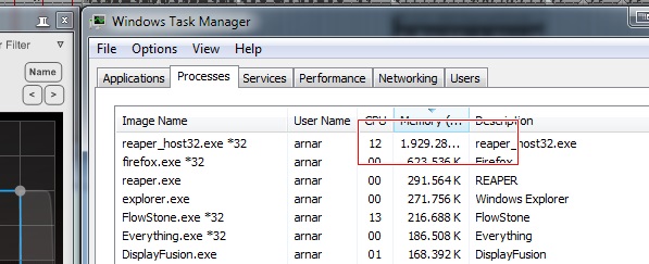

So I have been trying to chase down this memory leak.
I first encountered this with the advanced envelope, traced it to the play position bar.
Then I removed that and the leak stopped, however , I noticed that when I moved a knob it started to leak.
So I went back to basic modules that come with FS , Echo delay - Compressor - Chorus etc.
Exported as vst ..stable in memory until I move a knob , then the memory increases....and stays that way !
This happens with everything I export as vst.. stock modules included - except for Phenom And BobK Synths for some reason, I can only guess that its made in a much earlier version ?
All sequencers from Nubeat7 with a moving position bar will cause a leak, let alone if you move any knobs.
It seems that the memory leak slows down when the gui is not shown, but still there.
Everything tested in both 3.08 and 3.09- also uninstalled, removed everything flowstone, ran a cleaner, reinstalled.
@Spogg.. exporting your Harvester from 3.08.1 - opening in Reaper - hitting play bar and not even playing the synth, its just sitting there and the memory usage grows and grows. Let alone if you play it, grows for a 0,5 Mb a second.
I have tried 3 computers , 3.08.1 and 3.09? I can hardly believe I am the first one to notice this ? This is a major problem as far as I can tell .For example -My project uses 2 advanced envelopes, two lfo´s , two circular sequencers and a moving filled slow scope. The memory leak is massive.
I can provide a bunch of examples , but let's try something basic. Here is the stock compressor as a FSM , export from 3.08 as VST, open in your daw.. open task manager , move a knob continuously or automate it and watch the memory grow.
Can someone confirm this please ? I am still having a hard time believing that I am the only one that has noticed this but I think I can say with confidence that this cannot be an issue for me only as I have run out of ways to test this!? If there is something wrong on my side I would LOVE to know. Please tell me I am going nuts or something.

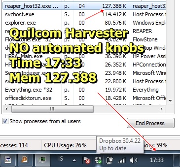

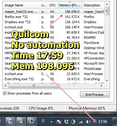

I ran Harvester for 26 minutes.
Quilcom - started .
Quilcom - after 26 minutes.
Quilcom - started .

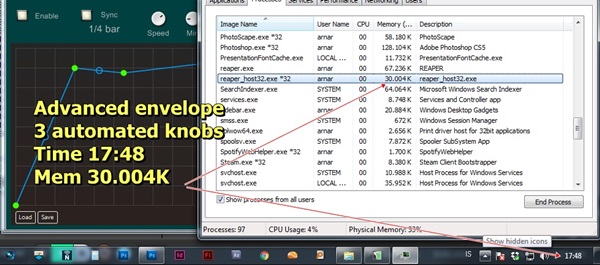

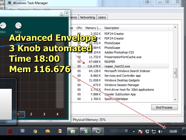

I also ran Advance envelope for 12 minutes
Advanced Envelope-Started.
Advance envelope after
