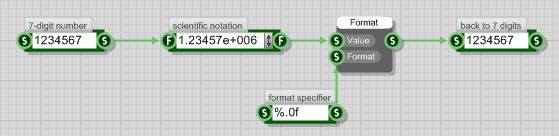

You can do this but frankly I would recommend Ruby. The Format String module is very picky about the format input: FS will crash on invalid specifier strings!
- undoSciNotation.png (12.87 KiB) Viewed 421475 times

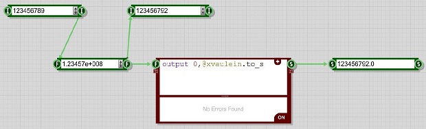

Here is my ruby simple code. It comes out with a strange error during the conversion.
The integer box does not covert the 9 digit number as you can see, but the next steps are different values. I tried to keep it simple with 123456789, but it converted to 123456792. Some thoughts? Thanks
- float to string ruby error2.jpg (35.77 KiB) Viewed 421456 times
Re: Float scientific notation
Not all integers that are representable in a 32bit int are also representable in a 32bit float.
Ints smaller than or equal to 2^24 (16.777.216) are all guaranteed to roundtrip through a float, ints bigger than that (like 123456789) might get rounded to the closest float.
