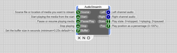

I was hoping someone may have done this before in Audio with the "Audio Stream In Module".
Check out this module, it can capture Audio from a remote location, then your second machine can process and play it.
StreamIn_Module
StreamIn_Module
I have done this with Video. I get an image from a Webcam, scale it, add an overlay, then have a Ruby module find the outer dimensions of an object, the "bounding Box", (basically to the CCD size x the lens magnification and my edge detection algorithm - works well ;) ). One computer transmits the image to an IP address, then I get the data on another machine. The frame rate is about 20Hz, not the best but for me it is fine.

Thank you very much, interesting idea. But how can I make/establish that one computer transmits sound to IP address please? (what exactly I should do?) and what to add as source file or location input - that Ip address ?
