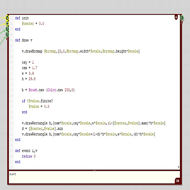

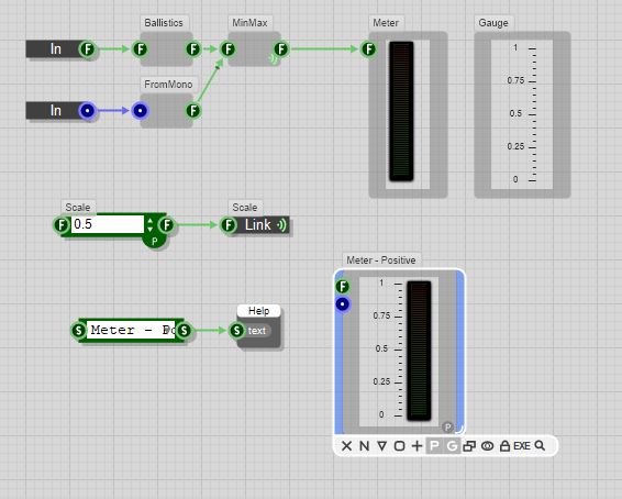

How to make the stock meter Db stay horizontal? Is it through Ruby settings? Which command lines do I have to change? Or is it impossible to do that?

I've never tried to "draw" things in Ruby, but I'm going to guess that if you switch the values for width and height, you will have yourself a horizontal slider.

Mr Duckett, I tried, I was changing and replacing values in Ruby and experimenting ... the meter almost became a spaceship and nothing to mark the movement horizontally ...

Of course a Ruby expert would simply re-jig the code, but it’s not so simple for most us.
So my “cheat” method is to use the Rotate View prim. This will rotate the view to any angle, as in the schematic. The tricky part is working out the 2 origins, so I use knobs to be quick and easy and then just set the values accordingly (because I like an easy life!).
The schematic also has a nice horizontal Vu meter (which is not mine) with a peak hold display.

Fantastic solution and thanks for sharing this horizontal Vu meter ...
I had searched the whole forum for days and there was only 1 post related to Vu meter horizontal, and here comes the solution!
Ruby really has to be well studied ... Thanks again and I just have to thank, (me and all other people who were looking for the solution).
