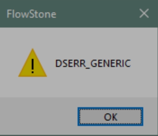

I've had these errors for a few days and don't know how to fix them. I'm using windows 10.
- error.PNG (5.73 KiB) Viewed 13734 times
- SmartSelect_20210422-083145_Samsung Internet.jpg (32.82 KiB) Viewed 13734 times

It means that FlowStone wants to use your microphone but windows 10 doesnt allow it. In the windows 10 settings enable the apps to use your microphone, and perhaps it will work
Re: How to fix DSERR_GENERIC and Direct Sound error ?
adamszabo wrote:It means that FlowStone wants to use your microphone but windows 10 doesnt allow it. In the windows 10 settings enable the apps to use your microphone, and perhaps it will work
Thank you very much I had microphone access disabled in the microphone options. I turned it on and the error disappears.
