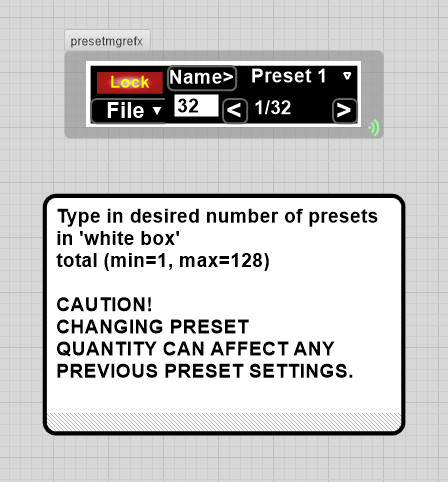

This modified version of the Preset Manager has an additional
text entry box (white box) for assigning the total number of presets.
Font size is increased for easier viewing.
Layout is rearranged and easy to modify.
Download includes the schematic file presetmgrefx.fsm and
the toolbox mod presetmgrefx.hom

Interesting idea to give the user the option of extending the number of presets.
Is the input box limited to 128 which I understand is the limit for VST specification?
Also how does it work in a plugin? The number of presets available is baked into the VST plugin, so changing it at the user level won’t change the VST. Also would the new increased number be saved with the DAW song?

Thanx for the input Spogg ...
I am going to eventually experiment with putting a limitation on the number of presets that the 'white box' can accept ... a simple 'bool less than >128' (boolean) algorithm should do the trick! Anyone who would care to assist is more than welcome.
My main purpose was to be able to actually access the preset quantity factor. It was previously necessary to open numerous mods within mods to locate the 'total box' so one could at least have more than the hard-wired code 1/1 default listing. I am fairly certain that the limitation is 128 maximum as you mentioned. This is and has been the standard for a great deal of time.
The following is for 'newbies' ... Spogg, Trogg, MV, BobF, Tulamide and Even Maik the Man Himself and others might like it as a 'refresher to what they already know!'
The preset manager automatically identifies the number of 'properties' prims as soon as it is placed in a FlowStone Schematic. Any mods with the 'p' pin link automatically upon its inclusion. Adding and/or removing mods that are assignable to preset control is acceptable within certain limitations.
The main 'File' button drop down list commands of 'save/load/save all and load all' are subject to the mods/controls compatibility to send/receive.
Preset management is primarily through 'wireless p pin' interconnects.
Some controls have prims that are not preset manager recognizable or if they are, will send but not receive control changes. An example is the SFZ sampler. It does have a 'p' pin embedded in the 'load' mod that will send information but not retrieve and reload an actual SFZ due to the nature of SFZ text file protocol. At present it simply does not contain File Read/Write for an actual soundfont because it must 'callup' a WAV file for MIDI processing. Each time a preset is saved for the given schematic if it contains one or more samplers they send file path information that is repetitive such as: "C\Program Files\myfileagain.sfzC\Program Files\myfileagain.sfzC\Program Files\myfileagain.sfzC\Program Files\myfileagain.sfz ... until it maxes out usually at 255 characters ... which, of course disables everything! I believe what happens is the FlowStone Ruby Assembler tries to avert a 'Nyquist Truncation Overload' and might be why all of a sudden the entire schematic, program and computer hit a proverbial 'binary brick wall' and ... CRASH!
Then ... ? reboot ... delete the project because it just won't even fire up to fix it and ... well everyone knows. Usually by the time this happens your cerebral cortex is just too packed with code and connections to even remember what started out as a brilliant vst and ended up as a 'Very Stupid Trial and Error' workout.
So ... I found out that one could allow other mods controls such as knobs, sliders values and similar to work properly by simply 'clicking' on the 'SFZ p pin' and renaming it (such as N/A) so that is still connected but 'preset manager non-operational' to solve this.
I am going to post this much ... Spogg and start an additional reply post so as to try to not frustrate the courageous newbies and diehards (:
