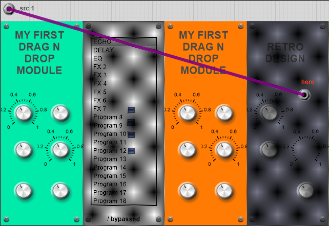

One cable was successfully implemented in the rack
-houston? -what... problem? -no, did you see that? :shock:
Snap 2020-11-23 at 18.56.27.png (107.47 KiB) Viewed 22707 times
