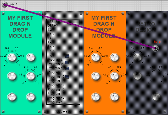

One cable was successfully implemented in the rack
-houston? -what... problem? -no, did you see that? :shock:
Snap 2020-11-23 at 18.56.27.png (107.47 KiB) Viewed 22672 times

Drop _3.3 + cables2.fsm
(1.4 MiB) Downloaded 1075 times
I got beer on it!
