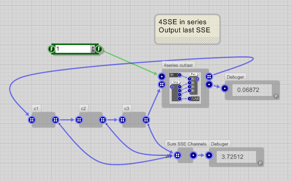

Here's a little add-on i like to use when using SSE in series.
This way one module will replace the in and out packers.
I made mono packs for 4x to 16x and stereo to 2x to 8x. With different output.
(It's also possible to include all of this inside one code..
But it could lead sometime to confusion, and slowing testing new code,...
i made them after breaking my head with some complex all-pass,
requiring to use SSE mix inside SSE mix, inside others bugs possibility inception ... ...)

Re: Sweat the assets using SSE
Hum ...
Just after i made all of those module, i discover that it's more smart to use the first one,
and to place simply the code in series like this :
