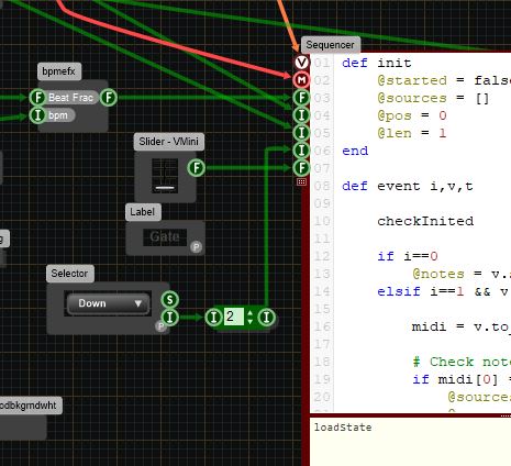

hi, thank you very much for this scheme, there is just something very important that I have not managed to get working,
It is the modality of the ascending, descending, combined and random sequence,
I think something is missing in the code, how to fix it?
modality
modality
2021-02-17 00_47_28-FlowStone 64Bit-Sequencer.jpg (42.43 KiB) Viewed 17921 times
I attach other scheme elaborated for me FSv3.0.6 schematic that also works for FS4 alpha
Midi SQ FS-306-Er_Version20.fsm
MidiSQ Er Version 20 FS 3.0.6
(1.53 MiB) Downloaded 1170 times
If they can write in Ruby the solution I elaborated,
to enable sequence modes
I would appreciate it very much.
