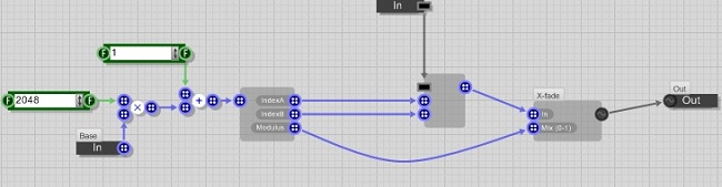

Now about the read out module.
I don't have the original dsp code for the part that produces the IndexA, IndexB and Modulus. from assembly code i gather this:
streamin base; streamout indexA; streamout indexB; streamout modulus;
intindex = whatever happens to(base-0.5);
indexA = intindex;
indexB= indexA+1;
modulus = base-intindex;
that 'whatever happens' i didn't get was this part:
movaps smIntVarTemp,xmm0;
fld smIntVarTemp[0];
frndint;
fstp smIntVarTemp[0];
fld smIntVarTemp[1];
frndint;
fstp smIntVarTemp[1];
fld smIntVarTemp[2];
frndint;
fstp smIntVarTemp[2];
fld smIntVarTemp[3];
frndint;
fstp smIntVarTemp[3];
movaps xmm0,smIntVarTemp;
What happens here?
There are some crossing channels and stuff like that i don't understand exactly. Some seem unnecessary..

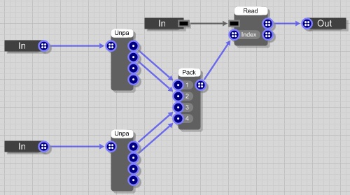

That readout module is a simple linear interpolation table lookup module.
Father wrote:that 'whatever happens' i didn't get was this part:
frndint;
frndint;
frndint;
frndint;
What happens here?
This is the old (pre SSE2) way of flooring an sse register. It floors the 4 floats seperately on the x87 float stack.
This is inefficient. Today you would just do
cvtps2dq xmm0, xmm0
cvtdq2ps xmm0, xmm0
The code looks like it comes completely unaltered from the output of a DSPCode Module.
The unpack-pack business should better be done with shufps instructions.
It's done to get the value in the table at IndexA into the lower 2 floats and the value at IndexB(which is just IndexA + 1) into the upper two floats.
Then the linear interpolation between the values is done in the X-fade module.
Re: Need some help with this Code
Posted: Sat Oct 29, 2016 10:58 pm
by Father
Ok let me see if i got it right, if that means just rounding to int basically we have to this in read out:
IndexA = RoundToInt[(Base*2048+1)-0.5];
IndexB = IndexA+1;
Modulu = Base - IndexA;
Readout = ArrayFromTransfer[Index a] * (1-Modulu) + ArrayFromTransfer[Index b] * Modulu
I'm guessing 'wave read' prim does something like index=max(input_index, array_size) so we also need a max(base,1) at the beginning.
Posted: Sun Oct 30, 2016 6:38 pm
by TheOm
Yes that's almost correct. Just a small mistake.
temp = (Base*2048+1)
IndexA = RoundToInt[temp-0.5];
IndexB = IndexA+1;
Modulu = temp - IndexA;
Readout = ArrayFromTransfer[IndexA] * (1-Modulu) + ArrayFromTransfer[IndexB] * Modulu
Father wrote:I'm guessing 'wave read' prim does something like index=max(input_index, array_size) so we also need a max(base,1) at the beginning.
I think you mean index=min(input_index, array_size - 1) and min(base, 1.0).
However, even if you clamp base to be less or equal to 1.0 the highest index that the code tries to access would still be 2048 + 1 + 1 (=2050).
I'm not sure what the point of the "+ 1" in "Base*2048+1" is to be honest.
