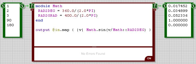

With RAD2DEG and RAD2GRAD module.
sin_array_1.fsm
(486 Bytes) Downloaded 1500 times
sin_array_2.fsm
(534 Bytes) Downloaded 1497 times
Sorry, I bad speak english.

My input is in degrees, how do I format it so if I put 180 in I get a 0 out? e.g. sin(180) = 0
