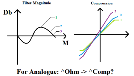

When we talk about filters, we are talking about magnetude ... I want to learn more, you can simulate resistors сомpression ? :?:
Filter Compression.png (23.35 KiB) Viewed 34195 times
