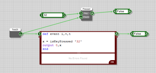

Hello,
Is possible to detect the SPACE key using the isKeyPressed method ?
tks

Space - is character 32 and in the Ruby isKeyPressed function it needs to be a string:
So SPACE = '32' (not 32).
spacebar clip.png (22.59 KiB) Viewed 10608 times
For other letters is easier just use the letter eg. 'q'

Thank you !
