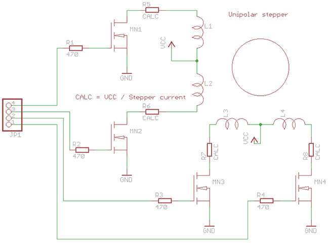

Re: Let's automate everything hehe(interfacing PLCs+)
nix wrote:http://www.phidgets.com/products.php?category=0&product_id=1002_0
Do you guys think this would be appropriate for driving a tiny( Epson printer) unipolar stepper?
I don't think so. The current from this is to low to drive such a big stepper. Also you don't need an analog output for this, a digital output with N-Channel Mosfet should do it. No matter what you use to control the stepper, you'll probably need an external power supply, because the USB-Port doesn't supply enough current.
Mosfets are pretty easy parts when you only want to use them as switches. They are special kind of transistors, there are basically 2 types, N-Channel and P-Channel. You need N-Channel-Mosfets. They operate like a voltage controlled resistor. When the voltage is high enough, the resistor is very low (mostly only a few mOhm).
I've attached a schematic how you can drive the stepper with nearly any USB interface. But you have to make sure, that the external voltage source that drives the motor shares the same ground with your interface board. The interface board should have an isolated USB connection though.
You have to select the mosfets by some parameters, like:
N-Channel Type
ID > stepper current
VGS(max) > 5V
VDS >= Supply voltage
RDS(On) at 4.5V as low as possible
Qg as low as possible
You should use digital outputs to drive this, because it's much easier and cheaper... Also analog outputs are mostly very slow, because digital to analog conversion takes time and this reduces you drive speed.
N-Channel Type
VGS(max) > 5V
Mighty Thanks!!
I will give this schematic to an electrical engineering shop to build,
when I pursue stepper control.
Is the USB port on Phidgets or Flowboard isolated,
do you know?
What do the resistors do?(sorry, I really should know)
So I will use digital, and not control the voltage,
as would be possible with the analog.
What measures do I need to take to stop my power supply overheating,
if I use the signal to brake as well as move? Is that going to be a problem?

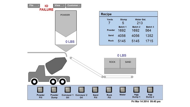

Nix-
I work on industrial controls for a living and I've done quite a bit of PLC and DCS programming. As a side project for a friend of a friend, I used Flowstone and a Labjack U3-HV with the relay board in an effort to automate a small readi-mix concrete factory. The basic operation is to put the right amount of water/cement/sand/stone/chemicals into a cement truck. The Labjack would turn on the solid state relays which would turn on solenoids that actuate big air cylinders and would also turn on starters for conveyor belts/chemical pumps. What I did with Flowstone and the Labjack was a fraction of the cost of using a typical Rockwell PLC/HMI. Also, it's easy to get fancy with Windows related things that you can't easily do with a PLC. I found a nice touch screen panel PC (fanless with solid state hard drive) and I was 99% done with the software and the guy backed out at the last minute. It was interesting at least. I actually programmed it first using Labview but since it's so costly it's not like you can install the development environment on a client's system so you can debug/troubleshoot it easily to so I opted for Flowstone and I definitely prefer working with Flowstone.
I've seen quite a few SEW Eurodrive motor/gearbox assemblies in paper mills. They normally seem to use a different brand of drives for them though. I think SEW Eurodrive is trying to sell these hybrid PLC/drive units to control their motors but haven't run into any of them yet. I'm curious about what model SEW unit you have. I might be able to find a use for one of them.

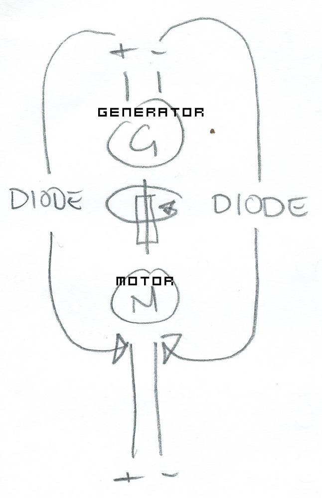

I have an electronics question. If the generator and the motor in the schematic are
small DC motors, does the motor climb in speed?->
