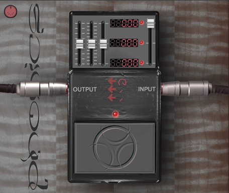

here is GUI-
It has 3 lines,
so you can play a chord.
Hope you like it,
I'm glad to get this working.
It sounds pretty good IMO.
Hope it gets tucked away in ur VST folder.

sorry there was a bad graphics bug-pls redownload-I have edited the original post with new link

sounds interesting and looks GREAT.... i´ll test it right now ! thx nix !

Thanks for the compliment on GUI,
finally I have my own algo to put in this skin.
