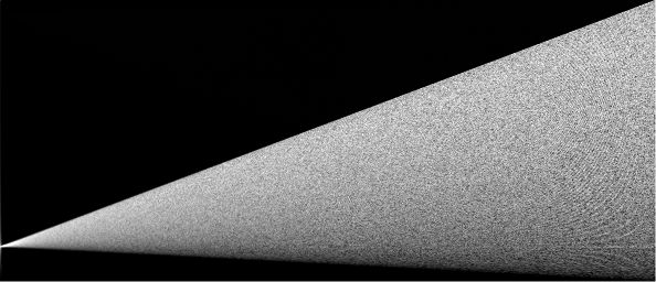

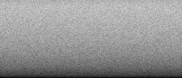

Ok, so I spent the day implementing this, I looked over at FS first, but coming from a traditional coder point of view it looks quite tedious to implement there. I also looked at Protoplugin but couldn't figure out how to sidechain it. So I ended up using Harmor to export the FFT in high-precision mode, and created the algorithm for the pixels per each column to morph between. It worked as I expected, but I need to turn up the particles further in number for an even cleaner transition (I used 40,000 particles). I wrote it in C# and just let it process.
Here are the sources:
SourceA
SourceA 1 Partial
SourceA 1 Partial
SourceB
SourceB 2 Partials
SourceB 2 Partials
SourceC
SourceC Noise
SourceC Noise
Re: Morph 2 FFT
Posted: Thu Aug 11, 2016 9:44 am
by eternith15
And here are the morphed results:
SourceA 1 Partial to SourceB 2 Partials
SourceA to SourceB
SourceA to SourceB
SourceA 1 Partial to SourceC Noise
SourceA to SourceC
SourceA to SourceC
It seems to morph anything pretty well so far, these are just the basics. I'll put up sounds samples likely tomorrow.
