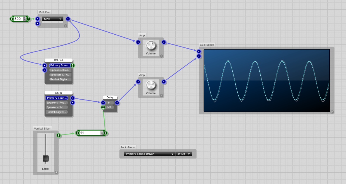

This works:
No drift clip.png (124.04 KiB) Viewed 11284 times

No, in a square wave all harmonics are always multiple of a base frequency. Can not be arbitrary.
And unceasing drift of a phase it not delays, it is beatings of differing frequencies.
In your schematic the same drift is present, irrespective of entered delay.
(I think, is a hardware effect.)
