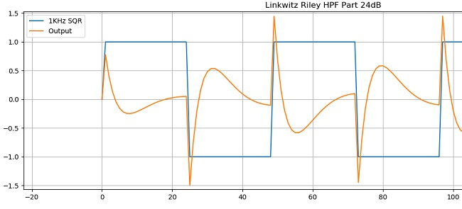

I'm playing around with a digital cross-over design when I noticed that the HPF adds unwanted energy to the signal, making it go over 0dbFS.
I've designed a very simple LPF and HPF pair of filters to cut the frequency zones into two parts: LF and HF.
I've tested the HPF by injecting a stimulus of 1KHz square wave at 0dbFS (limited between +/- 1.000 ).
To my surprise, the output of the HPF was much higher than 0dB, as can be seen in the attached graph.
Even though the input is limited to maximum(absolute(X)) <= 1.0 the output reached 1.5 !
In this case, how can I design a digital cross-over? Do I need to simply attenuate the signal to create more headroom (and lose output power)? I do not want to add a lookahead - limiter after the cross-over for keeping it simple. Will a clipper be good enough or will that introduce high distortion?
Why is this phenomena happening in the first place? Any ideas are welcomed

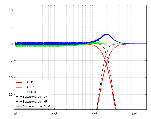

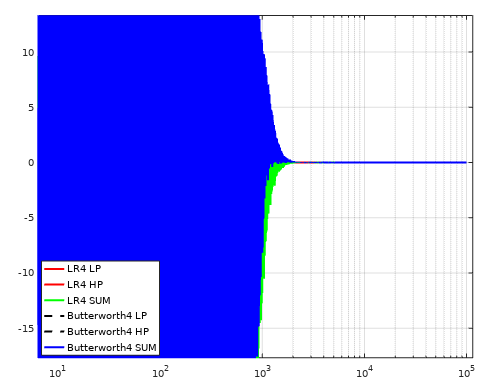

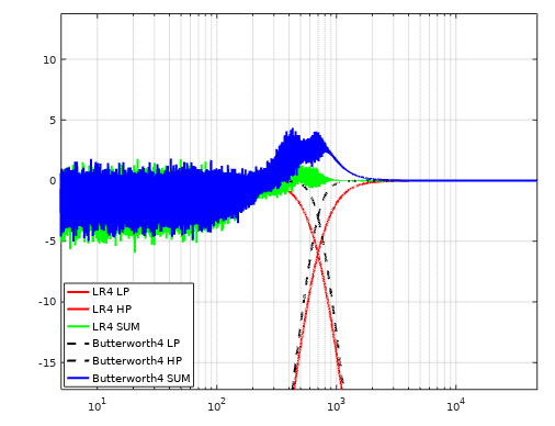

Replicated this issue in Audacity (with similar square wave) and find out that 24dB/oct HPF (fc=100Hz, fs=44100) had to be normalized to -3dB to keep the output inside the range of [-1,1].
Asked this on another DSP related forum.
NOTE: The commonly used (and sos Butterworth based) LR4 implementation suffers from distortion (maybe just numerical issue) when fc/fs is small enough. Attached few plots (Octave) which demonstrates this issue with parameters fc@200Hz for fs=44100Hz and fs=352800Hz and for fs=192kHz with fc=700Hz.

According to the answers brought to us by Juha_tp (on other forum) - this phenomena is expected and is easily seen with square waves.
Let's assume this is true - so what is the remedy ? I mean if I use a digital domain cross-over with an HPF for the "tweeters" - do I need to add a limiter or clipper against such possible inputs?

Rocko,
the overshoot may be unexpected, however it is not an artifact, nor a distortion. And it is not a digital phenomenon either - the same happens with an analog filter response. The highpass filter will respond to sudden changes immediately, whereas the lowpass filter will follow long term average trends. Therefore, even if the signal power is diminished after filtering, it may have a higher amplitude at some instant (= overshoot). When you recombine the LP and HP filtered branches, the overshoot will likely go away (unless you mess with the phases in between).
No need to worry, FS will handle signal amplitudes within the single precision range (-10^38 to 10^38 or so) allright. Only when you pass it to the soundcard, make sure it does not exceed +-1 (use a clipper). I usually throw in a volume knob and a clipping indicator at the end of the processing chain.
