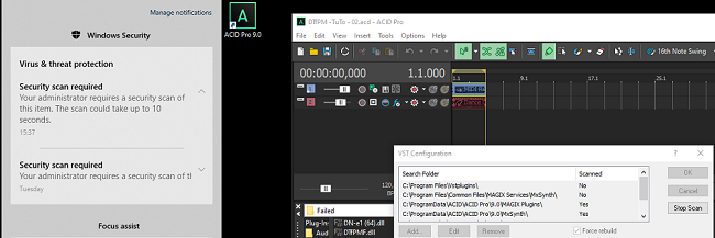

Since a few days I'm struggling to export/create/render a very simple plugin in VSTi.
AT first, I thought it was because of my bad programming skills ;) ...
I tried my exported VSTi in Acid (which is my main DAW), in FL (last version 20.something, updated last week), no cubase ( I own a old version, so I did not install it when I switched to WIN10), but no luck... each time the plugin is considered as failing...
So I also tried the exportation with FS 3.06, didn't work... FS 3.08... same deal... Still thinking it comes from a bug inside my schematic... So last resort...export with alpha... and then... I got that...
Failed Plugin scan.png (97.7 KiB) Viewed 22525 times
The plugin finally loaded after this 10 sec scan... (but was not working because of the rendering with alpha :( )

After deeper investigation, and turning off real-time protection, export with 3.08 was possible... :)
