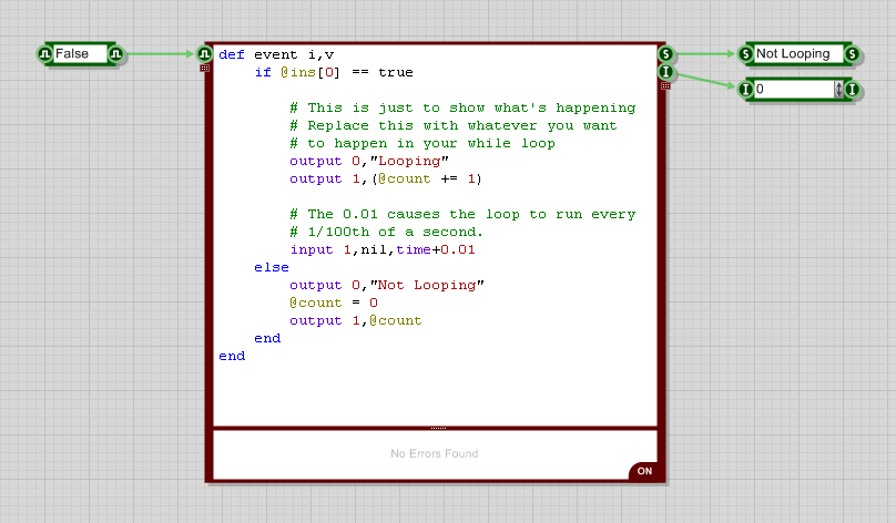

Try this, this uses the FlowStone events system to add a delay to the loop and therefore avoids an infinite loop.
while loop break clip.png (29.04 KiB) Viewed 21195 times

Thanks for the very useful code, I see the delay is working and definitely needed, if I reduce it from .01 to .001 flowstone has an error.

I see how the repeating if statement is equivalent to a while statement but I have not found a way to break out of the event method. If I add a "break" statement in the else loop I get an invalid break error. See below.
else
output 0, "Not Looping"
@count = 0
output 1, @count
break if @ins[0] == false
end
Invalid break.
The ruby part will happily run up to around 20Khz, ( 0.00005) but if you output this into the GUI system to display it you will overload the PC. Hence while it works ok at 100hz (0.01).
