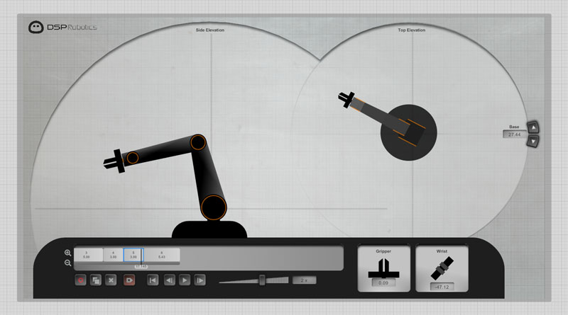

I have been working on a similar project with DSPRobotics for animating a robot arm. This has a new sequencer that DSPR has made in Ruby, it has a time line and you can edit the key frames etc. it will be perfect for your a application.
It's not quite finished yet but it should be done in a few days:
Ruby FlowArm3-05.jpg (58.27 KiB) Viewed 25082 times
Once it's done it will be posted in the examples area for all.
