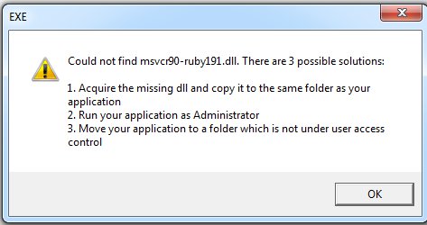

Hi,
i have installed flowstone 2 demo on different folder than v1 professional, but after doing that, i get the attached popup with exe exported on v1.
Even adding the msvcr90-ruby191.dll to the same folder where the exe is located the popup appears and only reinstalling flowstone v1 solved the issue.
- missing_dll.jpg (21.21 KiB) Viewed 24600 times

hi,
i'm on windows 7 64 bit and it's not a ram problem, it's related to a conflict between flowstone v1 and the ruby functionality of flowstone v2.

hi Anthony,
maybe my first post is not clear.
I have flowstone v1 professional and i wanted to try flowstone v2 free version on the same system.
After the installation of flowstone v2, the msvcr90-ruby191.dll error is related to exes compiled on flowstone v1.
So it's clear there is something in windows registry that points flowstone to compile the exe including the ruby dll which is only available in v2 and i don't see any relationship with bad ram modules.
After reinstalling flowstone v1 the problem disappeared, so i just wanted to let other people know what i have done to solve it.
