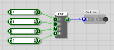

A question for the Ruby nerds out there: how do I create this simple function in Ruby:
Reason is I want to avoid unnecessary CPU load. The four inputs are basically constant, however they might change during stream excecution. I know how to code the Pack prim more efficiently in ASM, however that still involves unnecessary processing. When you have hundreds of packed data inputs in your schematic it does make a difference. :mrgreen:

Thanks guys. Yeah, that should be possible, although I was hoping that there would be an easier way. Like using the .pack("f") method or something. The inputs I have in mind are not stream data, they are more like triggered data. Sort of green, but with the four SSE channels being different. Like this:

Thanks, tulamide, this mem create module looks quite familiar ;) Yeah, it works, but it is a vast overkill. And then you still need to check for a valid mem address in the ASM, which is about what a hop instruction would cost CPU wise. Thanks again.
