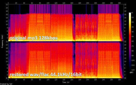

The last weeks i tried a project that should restore high frequencies to audio files that are not high-res or just saved as mp3 recording. I got to a result now after some days of work and wanted to ask for feedback.
I am planning a release of this tool but not today, but I will show you a converted file.
Preview:
As you know restoring something that is not present anymore is quite impossible - it is that impossible that it took quite long to get an idea how to restore something. So, if you restore something it is not the original - the goal just was to get a better sound - better than low quality mp3 and also better if you do an up-sampling from 44,1kHz to 96kHz.

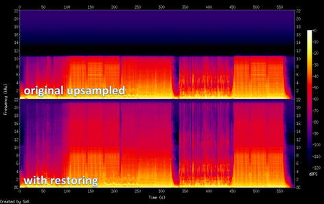

Well if they all sound the same, you may take a look here: I did speed the track down to the half speed. (Here you will here the restoring operations):
Download Half-Speed Multi-Track-Audio: https://www.dropbox.com/s/i4uqwo26twqv5 ... D.zip?dl=0
Track 1: Half-Speed Lossless Original
Track 2: Half-Speed reencoded Mp3 (Yes mp3 is really that lossy)
Track 3: Half-Speed restored Mp3
Track 4: Half-Speed Upsampled without restoring to 96kHz
Track 5: Half-Speed 96kHz restored

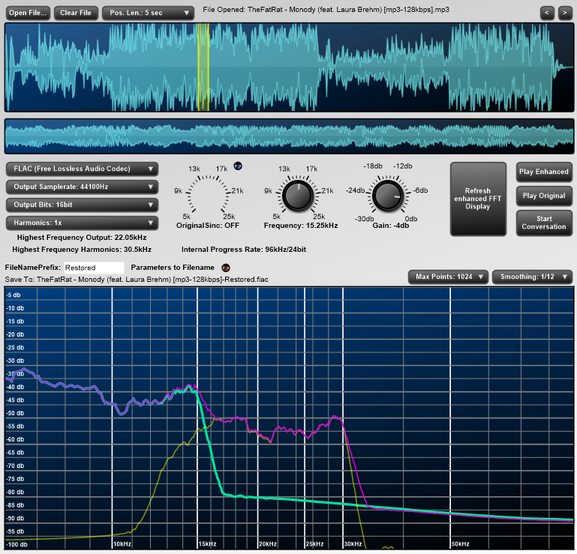

My Denon AVR (and also Maranz) has a restorer for lossy audio materials. As I wathed the spectrum what this thing does I found out, that they add high frequencies.
You all may have herd from harmonics that an additive OSC will generate. Those harmonics are calculated by a row series. So, the harmonics follow the same scheme each octave falling off a constant value in db. If you need more high frequencies you just generate more through the “Fourier series”.
Music Instruments operate most from 20Hz to 4200 Hz. Every frequency generated after 4200 Hz are harmonics and follow the scheme of the falling Fourier series.
So why not taking the last frequency were a song has the "fall off" because of samplerate, grabbing the last octave with a sinc-Kaiser filter and pitch it up with a phase-neutral pitch-shifter and applying some negative gain-offset. The result was that great that I got interested in this.

MP3 Spectrum normal speed:
44.1 kHz to 96 kHz half speed:

Well i have corrected those links to dropbox. I hope they are working now.
Using a distorsion may rely be an option - and i also found plugins that are doing enhancments by distorsion like this one:
https://vstplug-ins.com/soundrecovery.html
But i was not that happy with the result in hi-fi.
In my opinion distorsion is a good alternative if you have low cpu (Media Players and rly the most have mp3 enhancers). Converting the Pitch-Shift is taking fare more cpu :)
