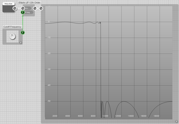

Here is a tunable 12th order elliptic lowpass as an example:
EllipticFilter.fsm
(14.24 KiB) Downloaded 1811 times
