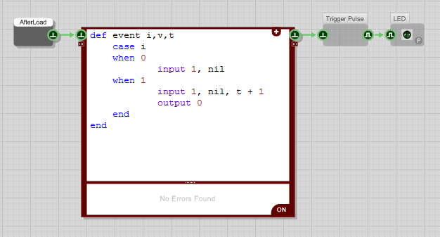

Simplest possible Ruby ticker below.

Posted: Thu Jan 09, 2020 11:21 pm
by Alexandre
Consider the first example. If it´s set to a period of 60 seconds and we change it to 1 second then it can take up to 60 seconds to update.
To fix this I will use the attached one for my project.
