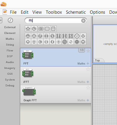

but do any of these prims help you?
fft prims.png (64.5 KiB) Viewed 35201 times
A 'frame/block' of audio can be manipulated into a float array
I'm really over my head here, but I understand frequency content,
maybe I can learn. Maybe ring modulation is interesting?
