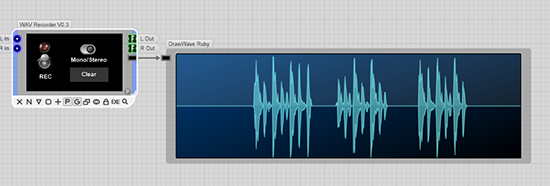

Hi guys, I was experimenting with dll component, and I figured out that it could be nice to build WAV recorder that doesn't need predetermined size. This is currently mono, but I will add another channel. Currently it uses double amount of memory for it's size, but this should be fixed also.
I am not sure if you will be able to use it on your computer tho, as I haven't still figured out how to do static binding in Visual Studio to ensure compatibility for other systems...
NOTICE: Don't include this in your project yet, before we confirm that it will work on every machine...

Re: Unlimited Size WAV Record V0.3
Guess I am the regular guy that you were looking for, Youlean. ;)
No luck here. :( Pressing the white On/Off switch activates the yellow LED (DLL is embedded), however the two green LEDs remain off (DLL not found and function in DLL not found). :? Pressing or releasing the Record switch does not produce any data at the Array output (yes, the audio stream is running). :( Apparently I can locate the DLL file manually but I don't know which file. :? Any hints? I am using FS 3.0.4.

martinvicanek wrote:Guess I am the regular guy that you were looking for, Youlean. ;)
Hey Martin, thanks for reply.
Try locating this dll...
WAV Recorder.zip
(4.87 KiB) Downloaded 1331 times

If locating dll doesn't work, that means that the problem is library linking when building dll. Exo has explained how to do it in Netbans, but I could't find same thing for Visual Studio. I have searched it for 3 days and I still did not find the solution, and to be honest, I am not even sure what to search for...
This could also be bug with embedding dll, because when I tried Exo's Poly Slicer, I couldn't get it to work, but after manually locating dll it was working just fine...

Hey guys, I think that I have solved problem with loading dll on different PC's. Please if this didn't worked for you, and now it is working, report here...
