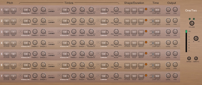

First rough assembly - CPU is about 30%, would appreciate any ideas on how get it lower.
Also, anyone know how to set his thing running and let it go on it's own without holding a key down. I've always used a quirk of VSTHost, where if one clicks on a plugin's GUI while holding down a key, the note will hold after releasing the key, only stopping when clicking a key again. Can there be a GUI panel switch that will just set this going?

I just had a quick go with this and I love it!
FS showed me about 7% CPU while the synth was running (core i7) which I think is perfectly acceptable.
I’ve attached a module I sometimes use which turns a set note on and off. It might be useful to start your synth going.
Using my midi keyboard I got clicks when I pressed a new note. I don’t know if that’s an easy or complicated thing to put right, but I think it would be nice to have influence over the notes playing. I know that goes against the principle idea of just running forever on its own, but I think it would be a nice option, if it’s possible.

Just added LFO mod of either or both modulators and the ability to solo edit each voice, which 'sounds' with each key press while soloing, without having to wait for it's loop to repeat (could you have look at how I implemented this - there's probably a simpler, more elegant way to do it - it's inside the All/Solo button, with wireless connections to each EG's trigger module). Haven't updated the OP yet.
A cool trick to remember with a three-stack is, with the first modulator in Fix Fr mode set to 1-6 Hz or so, it acts as vibrato, so each voice can have it's own speed and depth of vibrato, leaving the LFO for modulating timbre at a different (global) rate and independent depths. Independent vibrato needs to be very subtle though, or it can sound like a smeary mess.
Going to try adding a random mode to panning, so that a voice will appear at a different stereo position each time it's heard. Could also be useful to add randomization to the EGs' attack rates.
