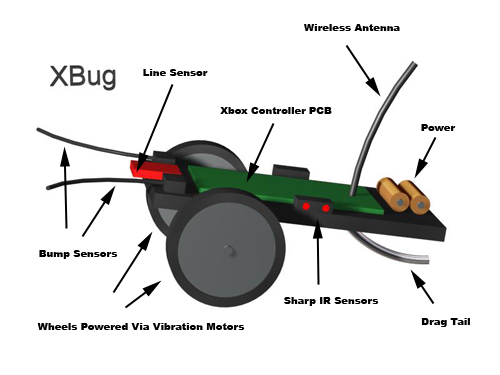

This is just up my street! I love making things out of junk and have been also thinking about making low costs systems for education that beat the Lego stuff.
Here's my idea: The XBug!
Very similar to what you are doing only hack an Xbox wireless controller instead of the Phidgets and the wireless USB.
Why:
1) The Xbox Controller is very cheap for a wireless one you can pick them up off ebay for around $40.00 USD
2) it is a DAQ something like 10 Digital Ins and 6 Analogue ins + 2 Analogue outs
3) It has two motors & controllers built in already (used for the vibrators). these can easily be connected to wheels!
4) It's wireless up to 30ft!
5) It's fully supported in FlowStone
Not bad for 40 bucks!
So you should be able to make an Xbug with a couple of Sharp distance sensors and bump sensors for a little over $100.
Maybe there could be a Xbug X-games where schools can go head to head in a competition!

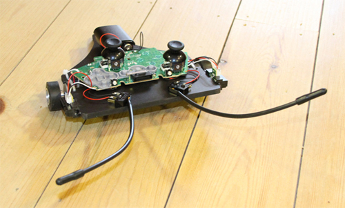

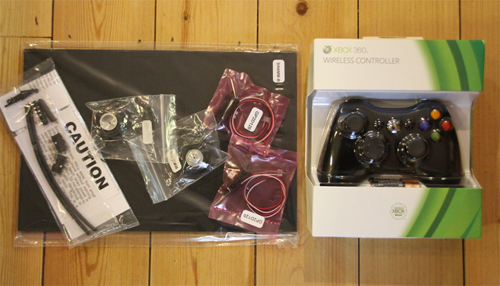

The bits arrived this morning for the XBug!
Here's the finished thing:
XBug FrontSLR.jpg (153.83 KiB) Viewed 26575 times
No had chance to test it yet with FlowStone as I'm waiting for the Xbox receiver (I thought it was Blue Tooth but it's not).

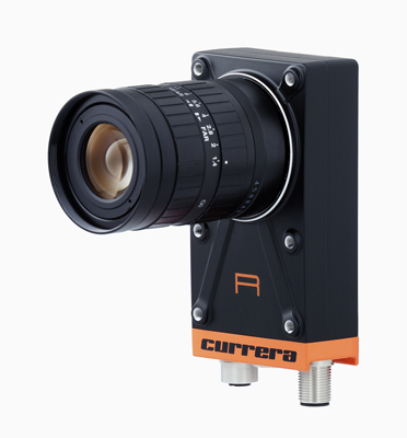

What would be really cool for your project is the new Ximea CURRERA-R camera with built in embedded PC:
Currera CameraLR.jpg (76.36 KiB) Viewed 26557 times
Yes this is a hires camera with a windows embedded PC built in, now supported by FlowStone :)

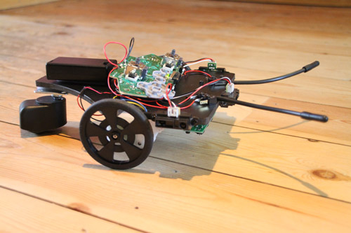

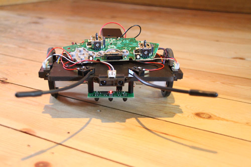

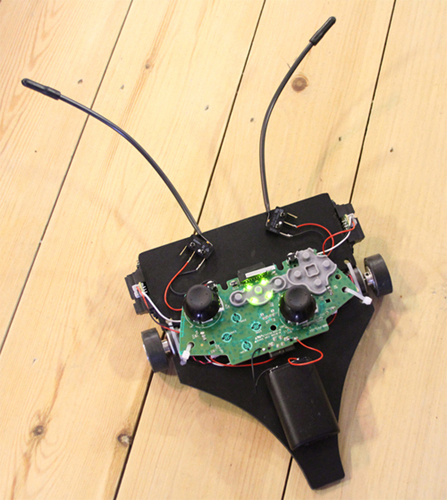

Also I managed to test my XBug today, it needed different motors and wheels but now works a treat!
I've had it roving around the kitchen autonomously and also line following - cool
