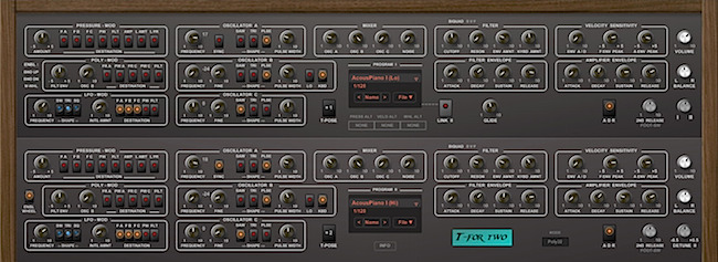

I did this Prophet T8 emulation and absolutely beat my brains out trying to give it the proper split keyboard option, but to no avail. I tried everything I could think of with both of these modules I dug out of Spogg's Synthmaker's Greatest Hits.
I don't know if it's the fact that my project has two Preset Managers in it (first time I tried that!), or what the prob is. The Ruby-based one worked fine in simpler test schematics, but I just failed to get it to work in this schem. The other one works OK, but triggers the envelopes in both split zones.
So, without the split keyboard option here's T-forTwo.
The Prophet T8 was essentially two Prophet 5s (with polyphony of each reduced to 4) with extensive velocity and aftertouch controls, and an excellent weighted piano-style keyboard. The two 4-voice engines could be played singly, with keyboard splits or layered together. The two were sent to separate left and right outputs, or a summed mono out. So the plugin represents two complete synths, each with their own preset manager so any combination of two presets can be used - layered together in mono or panned in stereo.
I tried to make this as accurate as possible and the only major 'upgrade' is the addition of a third oscillator in each.
Twenty presets (mostly from the T8 factory preset patch sheets) are included in each 'Voice'; several are in pairs (suffixed 'I' and 'II') and meant to be played together in layers or splits.
If anyone cares to take a shot at getting this to have the keyboard split option, that would be great to have that feature, but I'm bald as a cue ball tearing my hair out over it. Utter defeat.

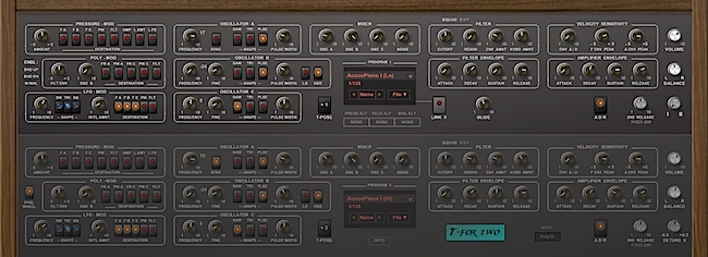

When the I/II balance control is fully CW or CCW, the unused 'Voice' is muted, cutting CPU in half, and it's panel is darkened to make the GUI less overwhelming and with less eye-strain.

Well, what I did was name the 'P' wireless outputs in the second Preset Manager - "II", then renaming each control's 'P' wireless inputs the same. The ones in the first PM were left unnamed as stock.
Your question about DAW behavior is a good one; I usually test my stuff with VSTHost, which is not a DAW; the only DAW I have is Tracktion, which I've never used to create a 'song'. I just record my Ambient noodlings, effects and all entirely within VSTHost, so I'm not sure I'd even know how to test what you say. Everything seems to work OK in VSTHost; I can set each 'half' of the synth to any patch using it's associated PM, but i suppose it wouldn't be possible to save any changes made to either/both of the selected presets as it's own compposite preset - so maybe the whole thing's a bone-headed idea. I just couldn't figure out how to replicate the T8's ability to have each 'engine' (they called 'Left' and 'Right' because they were connected to the synth's left and right out jacks) have it's own set of presets and to combine them in any way. I guess it would just have to be done by doing this as a single 'engine' and just have two instances open in order to combine presets. But then how does a DAW save a 'song' from two instances of the same synth, which have the same PMs? Also, do DAWs themselves have the ability to do keyboard splits; assigning two different synths to each half of the keyboard?

When talking about keyboard splitting (which I use a lot), we talk about 2 separate modules that work as individual blocks. The non-splited block and the splited block. When one is in charge, the second should be killed completely, or you'll end up with stack keys when switching from one mode to another. What I did in the attached schematic is building those 2 blocks that being "killed" and "revived" when pressing the "split key" button. If you'll dive in to the split module in my attached schematic, you'll clearly see that the splitting feature works correctly now. But there is still problem with your synth, probably because of using the 2 PMs, so the audio often stacks here.

Thanks k - I see the problem you describe and your solution is very elegant. I'm checking it out now with a version that has a single PM.
Thank you for checking it out.
Update:
Got this rejiggered split module incorporated into the single-Preset Manager version and danged if I can find anything wrong with it - works just as it should. Hats off to kortezzzz!
Just refining the presets for this version and will post when done.
