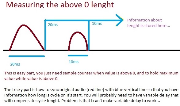

Look at the picture. I could post a FSM if you need it, but it is very messy...
Basically I want to calculate cycle length and to have that information right before cycle occurs, so I can set accurate release, independent for every cycle in envelope follower.
Logic is to:
audio -> fixed delay
audio -> sample counter -> variable delay(fixed delay - cycle length)
Logic is to:

As you suggest All you have to do, is to put constant delay on original audio. Detect the positive pulse length from the original (non-delayed) input. The event you want to happen should occur at constant delay minus detected length. That is the amount of time you need to delay the "side-chain" input, if you wish so. The delay will be modulated in a jump fashion but that shouldn't be a problem.
Re: Advanced DSP Question
Youlean wrote:What do you mean by sample to sample differences?
(sampleN) minus (sampleN+1). In short terms - gain differences between samples. Following curiosity - I'd like to see - how much fluctuations are going on in dynamic ranges defined by bits (or 6dB steps). And then - I'd like to hear what it means in audible terms.
KG_is_back wrote:As you suggest All you have to do, is to put constant delay on original audio. Detect the positive pulse length from the original (non-delayed) input. The event you want to happen should occur at constant delay minus detected length. That is the amount of time you need to delay the "side-chain" input, if you wish so. The delay will be modulated in a jump fashion but that shouldn't be a problem.
Indeed, there where some bug in my schematics, but now it seams to work...
