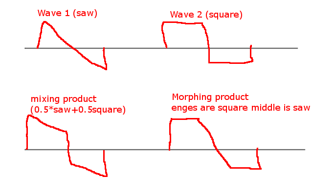

In cross-mixing means that the wave=x*wave1+(1-x)*wave2;
Morphing means changing shape from wave1 to wave2 but not necessarily by mixing the two waves - morphing is wider term.
Image below shows mixing product 50/50 of the waves and a morphing product calculates as beginning and end of waveform= square and middle = saw. This is just one way to morph between waves.
- morphingVSmixing.png (12.65 KiB) Viewed 37603 times
