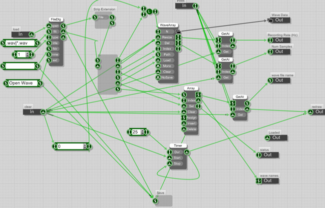

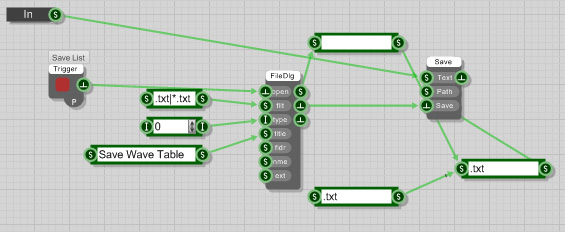

- Inside the save mod - This is from another OSM that seems to save but it's for the single sample instance of the OSM which has a different setup.
- multi-save2.jpg (44.97 KiB) Viewed 37607 times

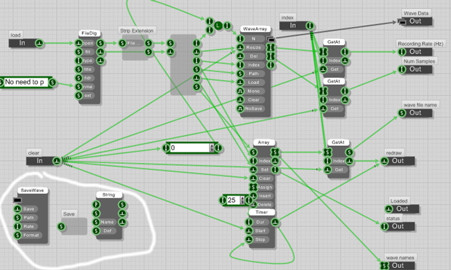

- Inside the standard WaveLoader that comes in the multi-sampler - notice my little save mod on the bottom. No clue where or how it's supposed to be configured or if it should be one level up?
- multi-save1.jpg (99.62 KiB) Viewed 37607 times

Hi KG, thank you for your response.
Are you saying that this is for reopening in a VST or just in SM - or both?
I've located and tried a few combinations with the preset string - no luck
I've made a quick OSM file with a preset manager and all three variations of modules I've tried (shown on the bottom of the jpg attached too) various combinations with - if anyone would be kind enough to tie this together it would be greatly appreciated and I'll show a token of my appreciation to your paypal and hopefully others will benefit from this.
Fingers crossed and thank you in advance!

Well, with a few modifications it's working in here. I used the string preset primitive to both save the path and trigger the sample loading. Formerly the sample loading was triggered by the dialog primitive - I have changed that so the dialog OK "sample and holds" the path that it outputs. That goes to the path/name separator and the path now goes to string preset. Output of string preset then puts the path to the part that loads the samples and also triggers it.
Try it on your machine if it works and let me know.

Success.
KG THANK YOU SOOOO MUCH! Ummmmm :: Are you single?! Nobody has made me this happy this fast in a long time!
haha.
Do you have a paypal account you can PM me so that I can show you my gratitude?!
I just loaded up two instances of it in cubase with different folders for each instance and sure enough once re-opened the samples are there and correct for each instance.
This means a lot to me - I can continue and finish the darn thing now (3months!) so thank you again it was a few minutes of your time but is priceless to me and mine.
