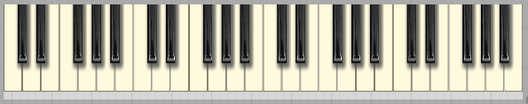

here is a keyboard built with ruby,
i tried to comment the code with sense but some parts will be a bit confusing because it has 2 area containers one for black notes and one for white notes - it was the only way for me to make it work, maybe there are some better ways to built it up
its fully resizeable and also offers a latch mode where you can turn notes on with one click and off with a second click on the note.
v.04 : fixed out of range bug when dragging out of keyboard area
v.06 : last fix did just half of its job (4.3.15)
v.08 bmp: the bitmap version which uses images for the the keys

Nice work NuBeat, resizable too
I think the structure is fine, keeping the black and white keys separate makes sense to me.

Structure looks clean IMO
Very nicely done- much appreciated.

Just to give some details of what djbrynte means.
The bug comes when the keyboard is being redraw while notes are playing and you open a drop down selector, it causes the audio to freeze and loop. This is Flowstones thread protection working and look like only way to avoid such a situation is to not redraw the notes with incoming midi.

Has anyone already tried Ruby's Thread.new in this context?Exo wrote:This is Flowstones thread protection working and look like only way to avoid such a situation is to not redraw the notes with incoming midi.
