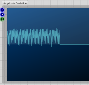

Okay, so I did some more testing regarding drift of those freely running recursive oscillators, with some interesting results. Below is a log from an overnight run. The display shows the amplitude deviation from unity magnified by 1e+4, taking 1 sample each minute. The amplitude fluctuations are confined to a band of possible values, there is no growth or exponential runaway. I would have expected a random-walk-like deviation proportional to the square root of running time, however the oscillator seems to get trapped in a limit cycle instead. I found this behavior in all test cases in a wide range of initial conditions and input parameters. So this is good news.

martinvicanek wrote:The amplitude fluctuations are confined to a band of possible values, there is no growth or exponential runaway. I would have expected a random-walk-like deviation proportional to the square root of running time, however the oscillator seems to get trapped in a limit cycle instead. I found this behavior in all test cases in a wide range of initial conditions and input parameters. So this is good news.
This is good news indeed. And quite surprising too.
