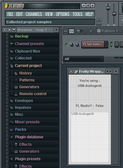

Sorry to disappoint you. The midi in devices prim does not list the daw, since they are no midi in devices. That's why it won't work.
Fl test.jpg (152.19 KiB) Viewed 29442 times
(USB-Audiogerät is my midi controller keyboard)

tulamide wrote:Sorry to disappoint you. The midi in devices prim does not list the daw, since they are no midi in devices. That's why it won't work.
It doesn't list FL Studio in the string array at all (the text box inside the module)? It does on both of my machines.
Re: Identify DAW (check if FL Studio, etc.)
Posted: Tue Sep 16, 2014 3:22 am
Perfect Human Interface wrote:It doesn't list FL Studio in the string array at all (the text box inside the module)? It does on both of my machines.
Right, I added the text box to see if it is listed below the first entry. The FL version of Flowstone seems to be handled completely different. Kind of like a host inside the host, where the inside host is fed with midi in from the outer host. If that makes sense at all :?:
