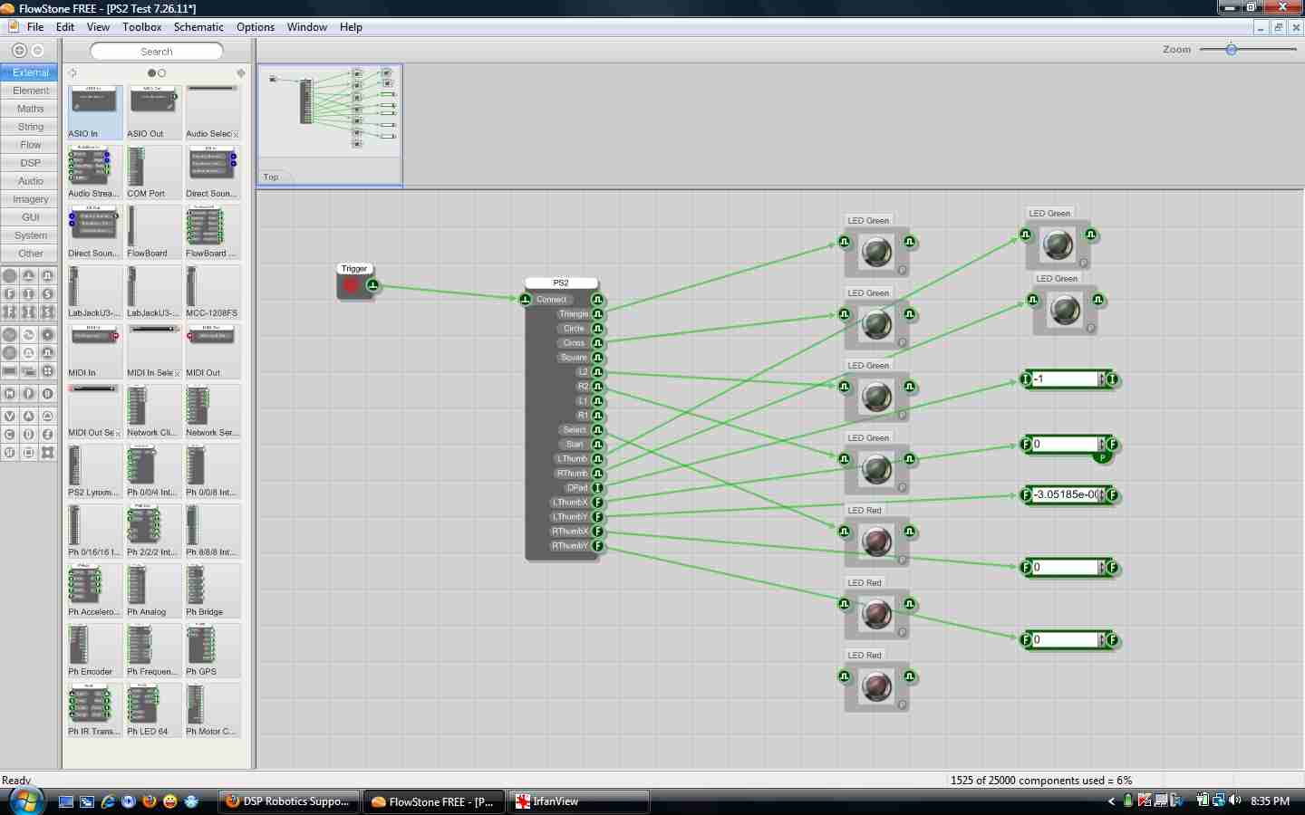

Okay, so I went ahead and bought the Lynxmotion PS2 gamepad to work with FlowStone so I can keep testing this kick-butt software.
The good news:
It's working with both the analog and digital functions.
The bad news:
1) Left thumb Y-axis constantly reports noise jumping all over the place (see screen shot). Once I deflect the joystick a little either way - maybe 10% - it then quiets down and gives a normal reading. Once near neutral, it goes nuts. The other three axis are fine.
2) Both L/R thumb X/Y-axis swing fully from -1 to 1 with only about 50% joystick travel. So from neutral to 25% forward deflection gives a full reading of 1 and from neutral to 25% rearward gives a full reading of -1. This is a bummer because it severely limits the range of motion. Is this a hardware or software problem?
Does anybody know of solutions to either problem? Is the noisy left Y-axis a bad gamepad? I just received it today brand-new from Lynxmotion.
How about expanding the response range so I can use the full joystick throw? Does anybody from Lynxmotion read this forum?
Can someone please help? Is there anybody out there? Is there still an Admin on this forum? I feel like I'm talking to myself. Maybe my questions are too stupid, but bear with me while I learn.
I love FlowStone so far and I'd love to upgrade to the full Pro version, but I want to make sure it will work first and that there is some support.
Screenshot of Lynxmotion PS2 issues.
Kind regards,
Paul

Well, I got something going. But what is going is not very useful.
One of the channels is mostly noise and crap jumping around. See the pic I posted.
Is there any way to determine where the fault is coming from within FS? The 4-joystick channels look fine in the Lynxmotion calibration software.
Again I ask, is there any support for FlowStone? I really don’t want to pay $750 only to end up stuck on something as simple as a gamepad.

Yup, I'd second matti's post - I''ve been messing quite a bit with XBox360 controllers and have always got really nice results. There are a couple of points that think are worth mentioning though...
- All of the analogue controls (which for some reason includes the joystick centre buttons) are continuously polled, and so are always sending a stream of values/triggers even when you are not moving them. I've found it is well worth reducing the resolution of the controls to whatever you really need in order to cut down on the number of messages.
For example, I've been using mine to send out MIDI controller messages, which only have 128 possible values - so multiplying the value by 127, then going through an 'integer changed' primitive really helps to eliminate redundant messages.
- The OP mentioned the 'wild noise' from one of the analogue controllers. I've seen this too - but usually the numbers involved are incredibly small (in the screenshot you can see the 'e-xx' indicating a number too small to fit into the number of decimal places). Creating a small 'dead zone' around the centre that will send only 'zero' messages sorts this out; so that only deliberate movements of the joysticks send anything out.
