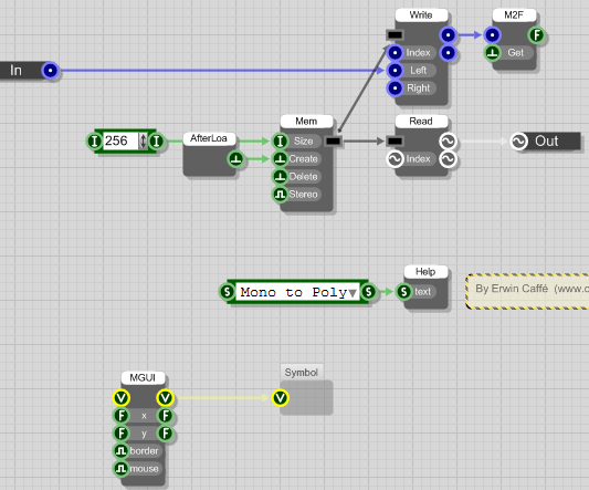

Hey, why doesn't this pass audio?
I swear I was just starting to work with something that converted to Poly, did some stuff, and then back to mono, and it was passing audio but then all of a sudden it stopped. Now I can't get audio through these modules, even in new projects.

You need a poly output from a MIDI to Poly to make poly streams do anything at all - the channels in poly streams are switched on and off by the MtoP assigning and releasing the MIDI notes.
The mono to poly would usually be used if you have a common signal that you want to pass to every voice of a synth. For example. if you wanted to have an LFO that had the same phase for every voice, you could feed in a mono LFO using the mono to poly.
The voices don't have to come from a MIDI driver though - you could use the MIDI Event primitive or Ruby to create notes to feed into the MtoP if you need a way to control the turning on and off of voices.

Poly streams are created by midi to poly primitive. Mono stream has SSE channels running always (the initiate when FS is loaded, code is recompiled or when "clear audio primitive" receives trigger). Poly stream can have any number of channels (including none at all), but they are created and stopped by midi to poly primitive.
Mono to poly module is basically a hack. Mono stream is written into memory (by mono write), and in poly stream the value is read from the memory (by wave read primitive). However, when no poly channels are initiated, the value is still written by mono, but there is no poly to read it. Mono to poly module doesn't create new voices on it's own.
I have used this same way, to create chorus effect, with adjustable number of voices (basically a flanger in poly, with unique modulation parameters per poly channel/voice). Note that using green to create midi notes this way is inaccurate - if you connect multiple "midi event" prims with "afterload" prim, the actual notes will be created with slight delay form each other. This may be fixed using ruby I believe.

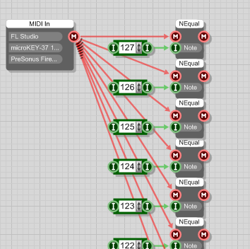

I'm hoping to make a polyphonic, MIDI note-following filter (notch, bandpass) effect. So the filter cutoff is controlled by MIDI notes. That should be doable, right?

Oh, and if I need to find the pitch/frequency of the lowest note currently played, does that require using poly (or voices)?

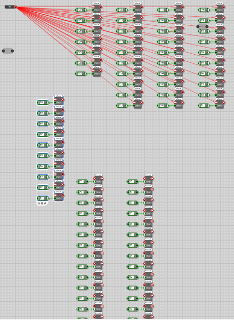

So do modules like the Signal analyzer just add the data together if there's more than one stream on the input at a time?
You'd think you could do it in MIDI data before it even hits poly, but I don't see a way to do that with existing modules either.
Actually... There. That should do it.
