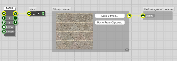

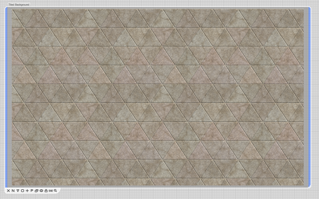

Another simple convenience graphics module. Tiled Background automatically repeats a bitmap as often as needed to fill the front panel. It is best suited for seamless tilable graphics, as the images show.
r1:
    fixed an issue with a cpu hog caused by 0x0 bitmaps.
r2:
    fixed an issue with misaligned non-square tiles.
    added a wireless input connector to mgui.

Thank you very much! It's always nice to have green and ruby versions, so everyone can use whatever is preferred. I like this version for its simplicity. Plus, it doesn't have issues with empty bitmaps (which was the reason for the cpu hog in my older version)

A couple of things:
-it doesn't seem to tile correctly with non-square tiles
-I can't see it in my plugin's top level (am I being stupid? :? )

Perfect Human Interface wrote:A couple of things:
Thank you for pointing this out to me!
- The second issue is solved very quick. I forgot to add a wireless input to the mgui. Just look inside the module and add it. I will correct this in a new version.
- I will investigate the first issue. But first I have to create a non-square tile :lol: I hope it's not the single precision floats that are causing this (then it's probably only doable with ruby)
