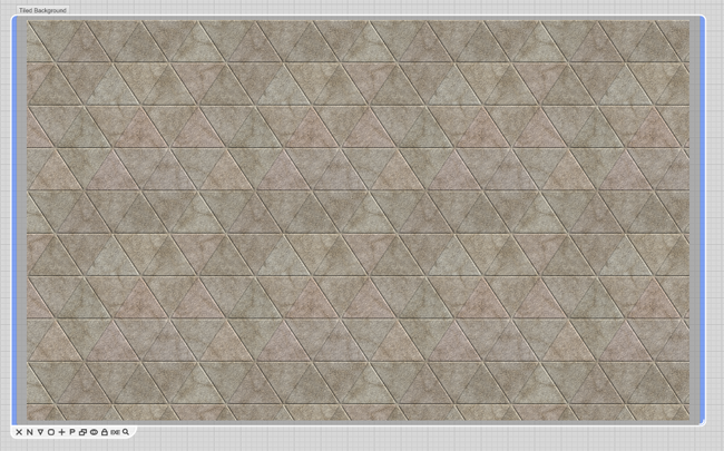

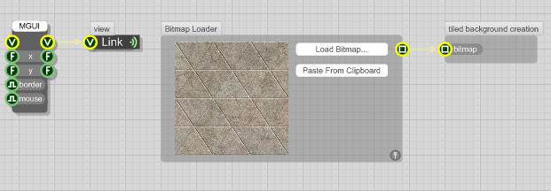

Another simple convenience graphics module. Tiled Background automatically repeats a bitmap as often as needed to fill the front panel. It is best suited for seamless tilable graphics, as the images show.
r1:
    fixed an issue with a cpu hog caused by 0x0 bitmaps.
r2:
    fixed an issue with misaligned non-square tiles.
    added a wireless input connector to mgui.
tiled_background(r2).fsm
(142.48 KiB) Downloaded 1172 times

you can do this also with ruby using the TextureBrush, here is an example
tiled_background_ruby.fsm
(3.83 KiB) Downloaded 1153 times

Nubeat7 wrote:you can do this also with ruby using the TextureBrush, here is an example
Thank you very much! It's always nice to have green and ruby versions, so everyone can use whatever is preferred. I like this version for its simplicity. Plus, it doesn't have issues with empty bitmaps (which was the reason for the cpu hog in my older version)

A couple of things:
-it doesn't seem to tile correctly with non-square tiles
-I can't see it in my plugin's top level (am I being stupid? :? )

Perfect Human Interface wrote:A couple of things:
Thank you for pointing this out to me!
- The second issue is solved very quick. I forgot to add a wireless input to the mgui. Just look inside the module and add it. I will correct this in a new version.
- I will investigate the first issue. But first I have to create a non-square tile :lol: I hope it's not the single precision floats that are causing this (then it's probably only doable with ruby)
