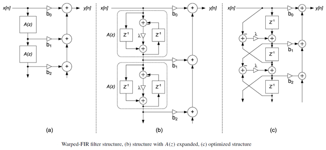

Those last weeks I've been reading about "Frequency Warped" filters that could be implemented on Flowstone, using DSP code or ASM code.
Those "Frequency Warped" filters base on the IEEE publication "Discrete Representation of Signals" by Oppenheim and Johnson, dating back from 1972.
In 1999, Paul Beckmann working for Bose, published "Frequency Warping in the Design and Implementation of Fixed-Point Audio Equalizers" at the IEEE.
In 2009, Ramos published "Cascaded warped-FIR and FIR filter structure for loudspeaker" at the AES.
In a nutshell, Warped-FIR filters borrow the topology of FIR filters, but instead of relying on delay cells, they use 1st-order all-pass phase shifters producing a time-domain smear, with a parameter (lambda) inside defining the amount of phase shift, hence the amount of "Frequency Warp". Due to the use of phase shifters inside, this is not anymore a "Finite Impulse Response" filter.
Is it possible to experiment Warped-FIR filters using Flowstone ?
What "lambda" shall we specify for a 128-tap Warped-FIR lowpass filter with Fc = 300 Hz when Fs = 44.1 kHz?
Can the highpass be complementary?
Can they exhibit a linear phase, natively, or do we need extra-filters for restoring a linear phase?
The objective is to have Speaker Lab automatically and interactively computing the Warped-FIR filter coefficients in realtime. It is expected that this way, the FIR length can be kept between 64 and 256, for materializing excellent speaker crossovers operating in the Fc = 100 Hz to 1000 Hz range, when Fs = 44.1 kHz.
Most publications remain silent about the phase. There seems to be a catch, like the Warped-FIR filter enabling a drastic filter order reduction (when Fc is very small compared to Fs), at the expense of losing the linear phase. So, if we succeed in implementing Warped-FIR filters for Flowstone, we could need specialized IIR filters for restoring a linear phase. Kind of joke! But, after all, anyway, I'd like to experiment this using Flowstone. And you?

steph_tsf wrote:Is it possible to experiment Warped-FIR filters using Flowstone ?
Yes, absolutely. For instance in the LPC project I used a warped filter although that was not a warped FIR but rather an all pole. It may be somewhat tricky to implement a long warped FIR filter in a CPU-efficient way, but then again it does not have to be very long if it is warped.
Hard to say, it will depend on further specs like stopband rejection, transition bandwidth etc.
I suppose it can, but must admit I haven't checked that.
No, certainly not linear phase per se. For linear phase you'd need extra filters. Why is linear phase so desirable? I like minimum phase because it has no pre-ringing.

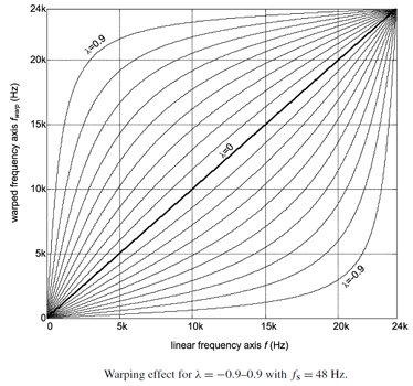

steph_tsf wrote:What "lambda" shall we specify for a 128-tap Warped-FIR lowpass filter with Fc = 300 Hz when Fs = 44.1 kHz?
Hm, I think you would probably want to map Fc somewhere near Nyquist/2 in the warped domain, so that would suggest lambda = 0.958.

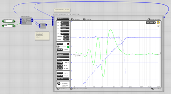

I defined lambda = 0.86 for getting a lowpass Fc = 1 kHz when Fs = 44.1 kHz
the lowpass selectivity look outstanding (blue curve)
the complementary highpass asymptot is 1st-order (20dB / decade) - that's quite poor
I'd like to try a lowpass prototype delivering complementary symmetric slopes, like a 3rd-order for the lowpass and a 3rd-order for the highpass - then see how it looks after the frequency warp
would be nice to have the coefficients externally defined
and yes indeed, phase is not linear
the lowpass impulse response looks tortured (green curve)
any idea how to restore a linear phase at a decent computing cost, say 16 or 32 IIR Biquads or so ?

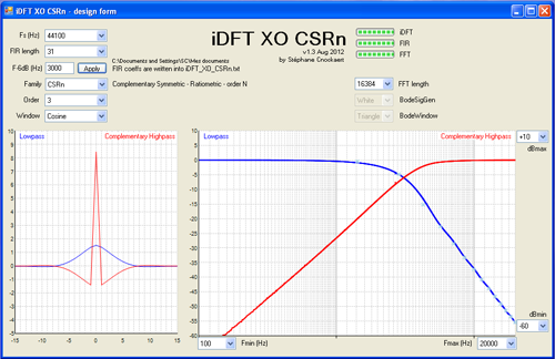

prototype 31-tap FIR lowpass filter I'd like to warp
it's a 3rd-order lowpass having Fc = 3 kHz when Fs = 44.1 kHz
as you can see the complementary highpass exhibits the same 3rd-order slope
this is working very well, as speaker crossover :
no preshoot
no ringing
decent slopes (3rd-order)
symmetric slopes
no relative phase shift between woofer and tweeter
no phase distortion (lowpass + highpass = unity function, magnitude and phase)

I'm very curious to see what's happening after frequency-warping it, for Fc = 300 Hz instead of 3 kHz

Oops, sorry, I had the coefficients wrong.steph_tsf wrote:the complementary highpass asymptot is 1st-order (20dB / decade) - that's quite poor
I think for lambda = 0.958 you'd need quite a few biquad allpass sections to restore linear phase. In that case the warped FIR filter offers no advantage over a IIR crossover in the first place.steph_tsf wrote:and yes indeed, phase is not linear
