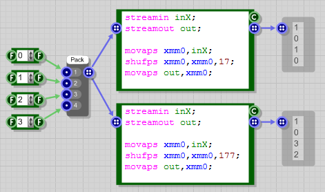

In that case, should the third parameter of the shufps instruction not be 177 rather than 17?KG_is_back wrote:It treats mono4 as two stereo pairs (0-1 and 2-3)
KG_is_back
- Posts: 1196
- Location: Slovakia
Re: Stereo Limiter
martinvicanek wrote:In that case, should the third parameter of the shufps instruction not be 177 rather than 17?KG_is_back wrote:It treats mono4 as two stereo pairs (0-1 and 2-3)
Yes
