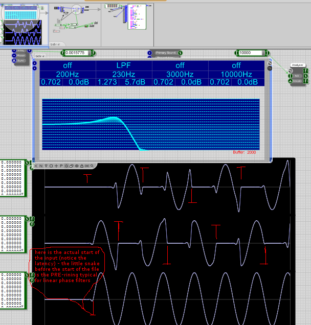

1. Captured impulse response by inputing an impulse. Also I've checked it by time shifting the impulse to make it out of sync with buffers. As long as the IR width was smaller than Buffersize the result was always the same no matter the time shift and no boundary effects were present (well, maybe some noise below 80dB). FFT shows the filter truly is linear phase and has the same amplitude response as two identical filters (the same biquad sections from the forwad-time version) in succession.
2. I've inputted a sine wave, set my settings and tried different buffer sizes. with low buffer there were harmonics present in the signal (and in the oscilloscope boundary effects were clearly observable), but after I've increased the buffer over certain limit they were gone and oscilloscope showed that the sinus line was perfectly jointing. I've done the same test with fixed buffersize and changing the settings of the filter, results were the same.
Here is an image I've made - an testing of the backward filter (the forward filter is bypassed). The first graph shows the output of odd buffers and second of the even buffers. The actual buffer boundaries are marked with red "T". The third graph is the sum of the two, which is actual backward filter output.
Here you can see, that the "tail" perfectly fits to the artifact at the start of next buffer.
- filter buffering.png (83.42 KiB) Viewed 60280 times
