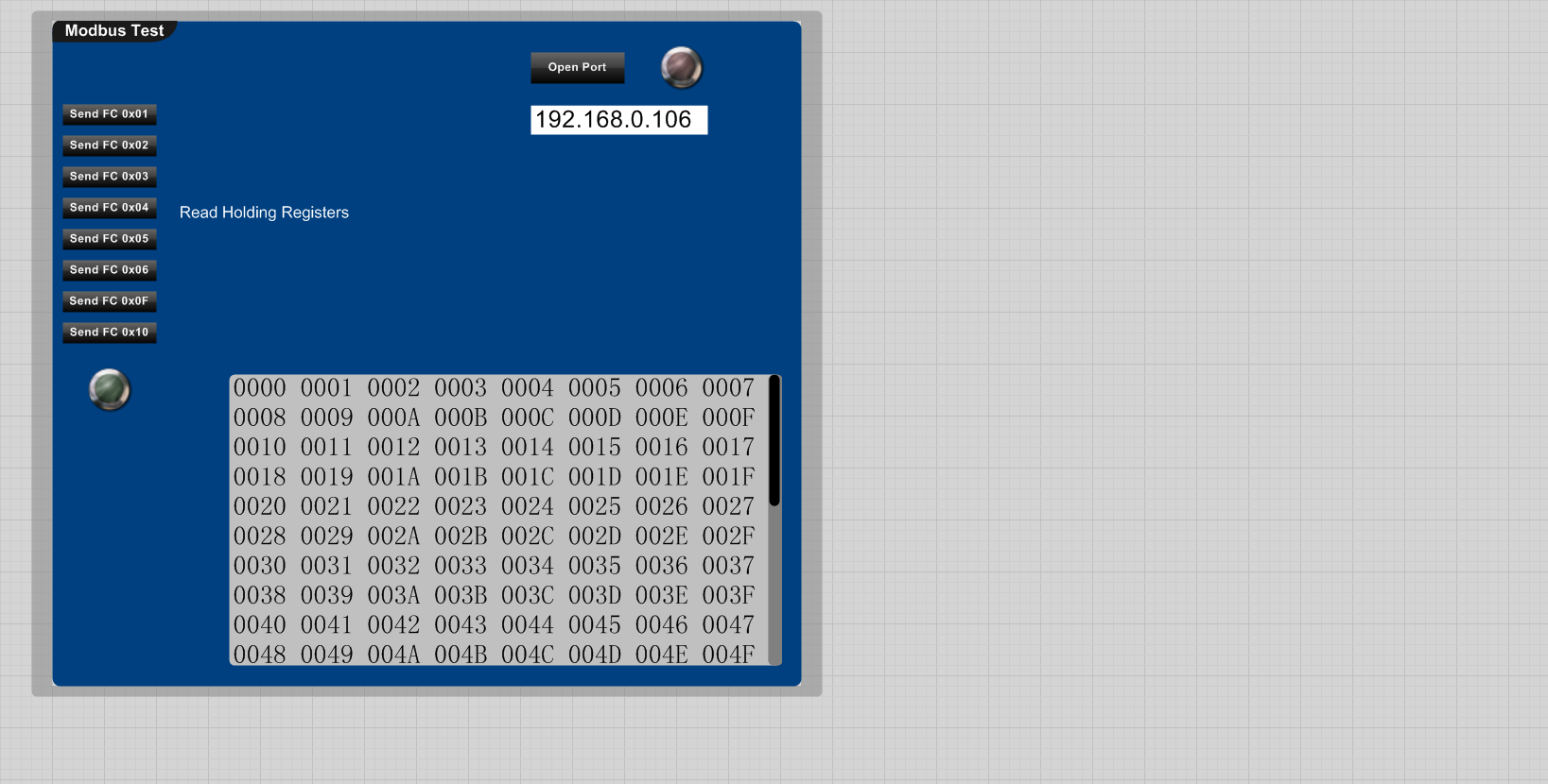

Here's my new Modbus TCP Client Test program.
Now included are all of the Function Codes to send and receive all types of data.
To test I used a Free Modbus Server App. http://www.plcsimulator.org/
Works a treat :)
Enjoy...

by Embedded
OK, here's the next version of the Modbus Client as you suggested.
In this version, I have simplified the UI to just write to 10 registers, with an address offset. The Hex values can by typed on screen or be sent to the module as inputs.
The read registers is similar with an offset etc. but this can be polled to automatically keep reading the given registers. The polling frequency can by changed using the provided knob. The read values are also sent out of the module as well as displayed on the screen.
There are also edit boxes for the IP address and port number.
I've not spent any time on the look of the GUI yet whilst we sort out the functionality.
What do you think?

Re: Modbus
Posted: Thu May 12, 2011 5:15 pm
by Embedded
I forgot to test the inputs - duhh
Anyway the inputs are now working correctly, and it seems no problem to have two or more clients so I have done as you suggested and split the read and write up. This does simplify things quite a lot as far as dealing with the error messages etc.
If the Write Client times out then the fist click on the write re-opens the connection and the second send the data.
